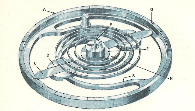

|  - http://gjselgins.blogspot.com/2012/08/durabalance-lord-elgins.html a écrit:
Durabalance Lord Elgins In 1958, Elgin introduce the Durabalance. This technologically advanced balance wheel incorporated several features.
The rim (A) was solid, rather than being drilled and tapped for balance screws. Poising was done by removing weight under the rim
The balance arms (B), rather than being straight, spiraled out from the center, and were flexible. This was to absorb shocks, so that movements of the heavy balance rim would not be transmitted to the fragile staff pivots. Students of horology will realize that this idea was not new, but rather was lifted from the Wyler Incaflex
The hairspring was a flat spiral, rather than a Breguet overcoil, and was free sprung, meaning that there is no regulator, and the entire length of the spring from collet to stud is free to vibrate. To regulate the rate, Elgin developed an ingenious system that made use of the spiral arms. Rather than changing the free length of the hairspring to regulate the rate as in a standard watch, the Durabalance allows the user to change the moment of inertia of the balance, by moving two weights (D) in or out. By moving the weights inward, the moment of inertia is decreased and the rate increased, and moving the weights out has the opposite effect. The weights move along the spiral arms of the balance, and are coordinated by the use of a flat steel spring (C), which connects them. Think of an ice skater doing a spin - the more tightly she holds her mass, the faster she spins.
It's a very elegant solution, in theory. In practice, it's a little clunky. To regulate the rate, you have to stop the balance and hold it still while you move the spring one way or the other, and despite those nice little marks on the rim in the picture, I've never seen a Durabalance that actually has the marks. It's strictly trial and error.
The first two movements to carry the Durabalance were the 730 and 750, 23 jewel 13/0 Lord Elgins. This watch, a Lord Elgin Fargo, carries a 730.
